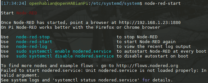

Manual Installation (optional)
If you are not using the openHABian Linux distro on your Pi, you can install or upgrade Node-RED using the following upgrade script command from the Node-RED Installation Guide:
bash <(curl -sL https://raw.githubusercontent.com/node-red/raspbian-deb-package/master/resources/update-nodejs-and-nodered)
You can start Node-RED with the following command node-red-start
- and stop it using node-red-stop
. To see the log, run the command node-red-log
You can also activate a SystemD job to automatically restart Node-RED when you restart your Pi using the command sudo systemctl enable nodered.service
