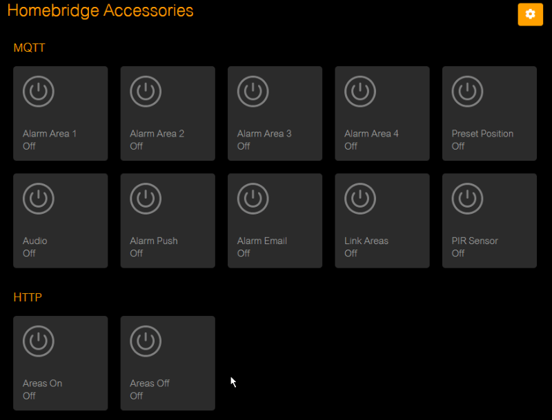

A: Yes - you can also use the HTTP interface (CGI Commands) to control your camera through Homekit applications. This can be done with the homebridge-http-switch that can be installed through the Homebridge UI - please read our Homebridge MQTT Tutorial for details on how to set up Homebridge with Docker:
In our Homebridge MQTT Tutorial we now added MQTT Buttons to control our camera - simply replace them by HTTP switches as shown below:

Pressing the Areas On button will switch all alarm detection areas on our camera with the IP address 192.168.2.117
and the admin login admin
/ instar
on. The Areas Off button will reverse it.
The CGI Command for this action is:
/param.cgi?cmd=setmdattr&-name=1&-enable=1&cmd=setmdattr&-name=2&-enable=1&cmd=setmdattr&-name=3&-enable=1&cmd=setmdattr&-name=4&-enable=1
/param.cgi?cmd=setmdattr&-name=1&-enable=0&cmd=setmdattr&-name=2&-enable=0&cmd=setmdattr&-name=3&-enable=0&cmd=setmdattr&-name=4&-enable=0
You are now able to operate all camera functions through buttons in the Homekit UI using the INSTAR CGI Commands.
