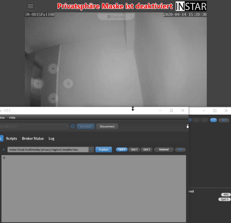

You can test each of those steps with programs like MQTT.fx or the MQTT Explorer and verify that everything is working as expected - before attempting to use the MQTT Topics inside your smarthome UI:
